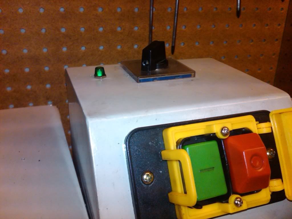

    Once I got it up I installed the QCTP I ordered from Lathemaster. Unlike the QCTP for the 7X10 it moved gibs up and down to lock the tool holder in place rather than pushing a cam mechanism out on the holder. I then put the belts on, and wanted to get this thing going. It has 2 safety switches, 1 E-stop and 1 direction switch. Unlike the HF 7X10 the chuck guard bust be down before the lathe can be turned on.... it took me about 20 minutes of playing with power cords and taking the back panel off to check the wiring before I figured this out. So because of that I wanted to add an indicator light to tell me when all safety's were on and it was able to run. I also started cleaning up all of the ways and everything that was coated in grease.
    Here is the indicator light I added. When the belt cover is closed, the guard is down and the direction switch is turned, it will light up telling me I can hit the start button.

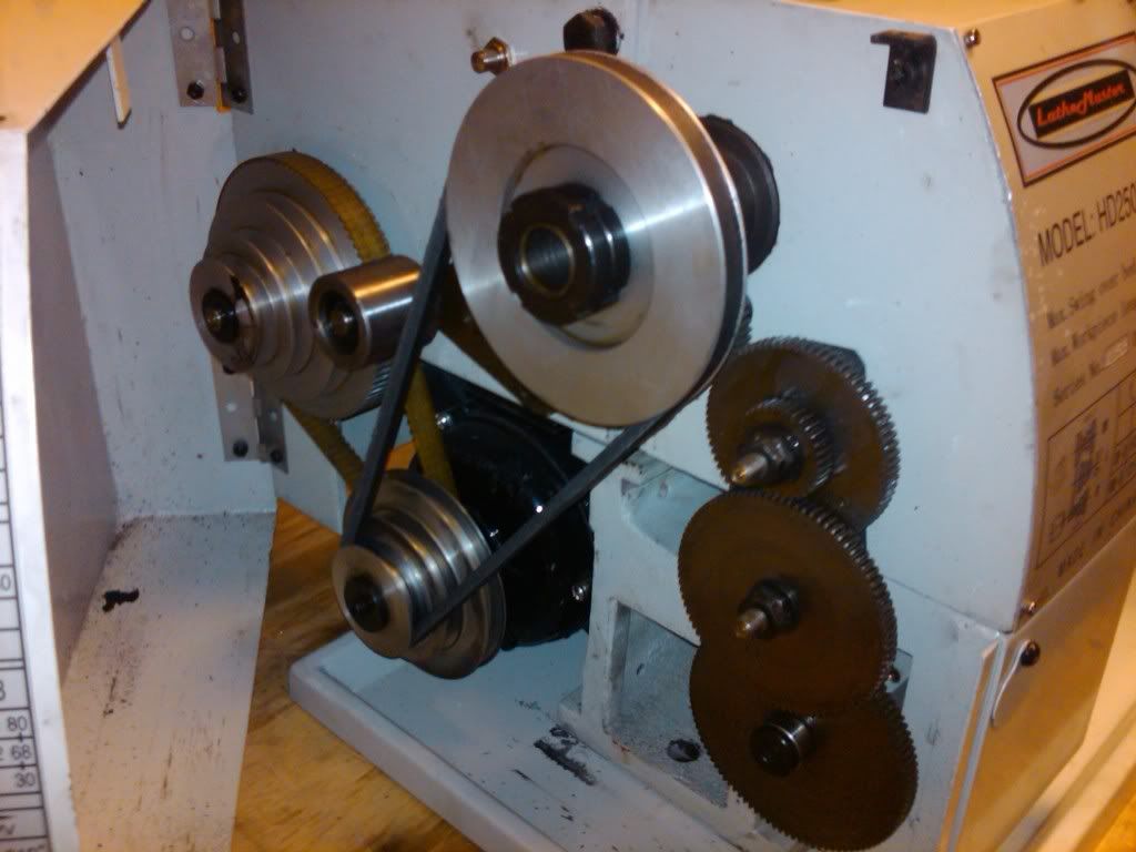

    Here is a pic of the belts and change gears.

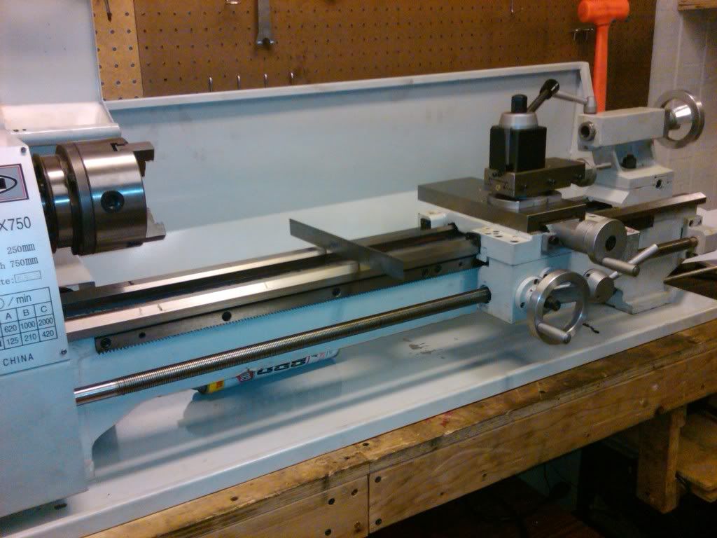

    Here you can see a 12" rule cross way on the ways to get an idea of the size.
    And once again the 12" rule at the bottom of the bed.
