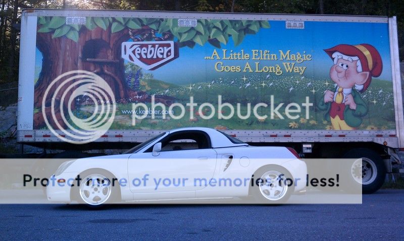

    I checked their site. Nothing I need. Many of the kit comes 12-13" rotors. Imagine this on 17s. This is 15s.
    I think if I make drop the body 1-2" like I've been thinking and put 17s on, it will looks wonders. Maybe even try to fit 18s, cor 17 front and 18 rear. Cut the fender out and I will do my own body work. Kind of like this.
    16s are limited to tires.
