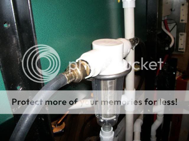

    Looking good! Now go to Lowes, in the well pump dept. and get this spin filter for trapping fines:
    Lowes item #25699.

    75 micron top filter for 32 gallon sump.
    Photo of the Pump.
    I will make a stainless drip pan that will funnel the coolant back from the machine into the top sump. This way all the chips can also go down the same chute and can be removed all at once by removing the top filter. Should make for a quick cleanup. 75 microns should do the trick when it comes to just about everything. Nothing of concern should be able to get past the filter. I don't think i will be making a sight glass, since that is just another opportunity for a leak to occur if the seal fails over time or gets bumped then creates a big mess. The pump will exit out of the top side of the container, above the waterline with a quick disconnect hose fitting. this will go to a flex fitting, and after its on the machine i will use PVC to route both air and liquid, and grey conduit for a exterior rated electrical plug inside the machine envelope, along with the lighting.
    Waiting to remove the bricks off the top of the table, that will happen this friday. It's hardened up a lot. Good thing i didn't wait 24 hours, its just not long enough.
