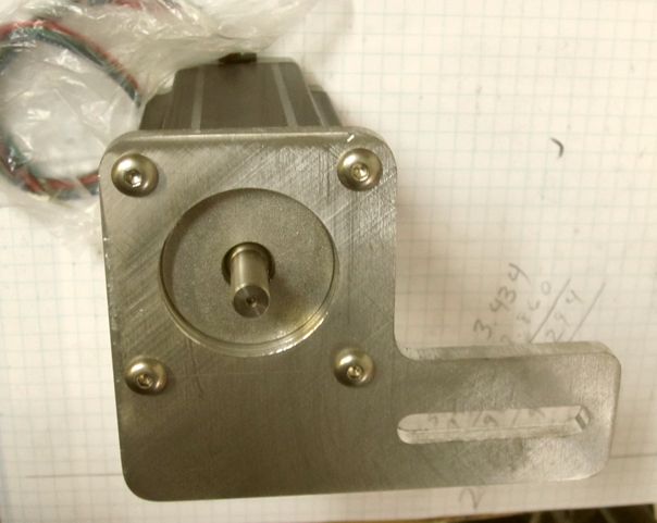

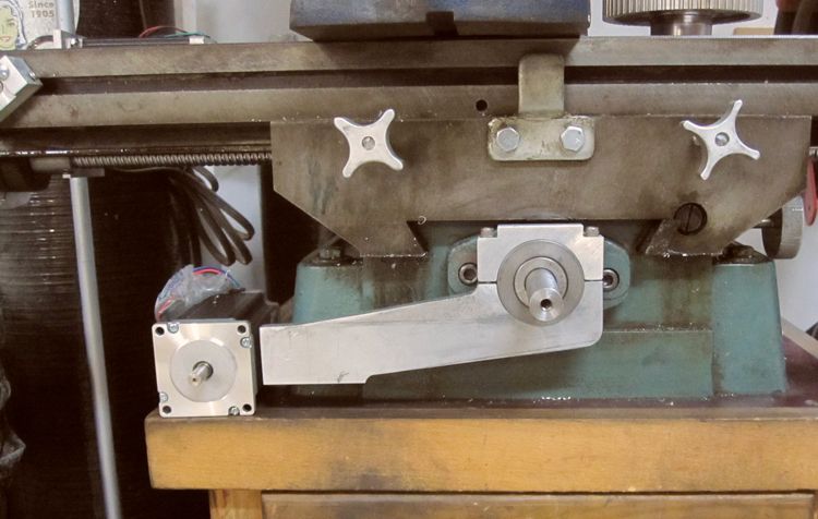

    Here's a picture of the Y-Axis motor mount (so far). Still have to make the part that attaches the motor to the arm.
    Chuck

    I think you're going to find the single-bolt motor adjustment will move over time, or when you have a "crash"....

  5. #5
    Join Date
    Dec 2006
    Posts
    73
    Quote Originally Posted by SCzEngrgGroup View Post
    Regards,
    Ray L.
    So, moving with a "Crash" would be a good thing, right? Keep something else from breaking? As far as moving over time, it's easy enough to reposition and tighten, as long as I don't have to do it every 15 minutes.
    Chuck

    Quote Originally Posted by cffellows View Post
    Chuck
    No, it won't do a thing to jeep anything from breaking in a crash, because the crash will already have occurred by the time it moves. It's just one additional thing that will have to be corrected after the crash. Besides, if it only moves a little, you'll end up with backlash, perhaps a lot, but you won't know it until your parts starts coming out screwed up. Far better to design to deal gracefully with worst-case conditions in the first place.....
    Regards,
    Ray L.
    Regards,
    Ray L.
    Hadn't thought about the backlash issue if it only slips a little. Thanks for pointing that out, I'll have to figure out a way to lock it more securely...
    Chuck

    I look at my timing belt as a "fuse" that will pop if things get to radical (yep, I have popped one) and save the hardware from major breakage. I would much rather break a $3.00 belt than tear up a $100 servo motor or worse!

    That is why I asked, because I saw the possibility of swivel on the bracket. Fine if it only occurs intentionally, but not cool if it happens without you knowing about it. Still interested in seeing it completed. I may cnc mine one day if I don't sell it first. It is for sale locally though through word of mouth. Everyone comments, "you mean it's a manual mill with the hand wheels on it? Yes. You ain't gonna get that size cnc mill that has 10 minutes of run time on it for $500.00.

    Here's the Y-Axis motor mount. It will be attached to the mounting arm with two 5/16" bolts through the 1 5/8" long slot. The bolts will be 3/4" apart which will give me 3/4" belt adjustment.
    I realize this could still slip, but with two bolts holding it, it should be much more secure.

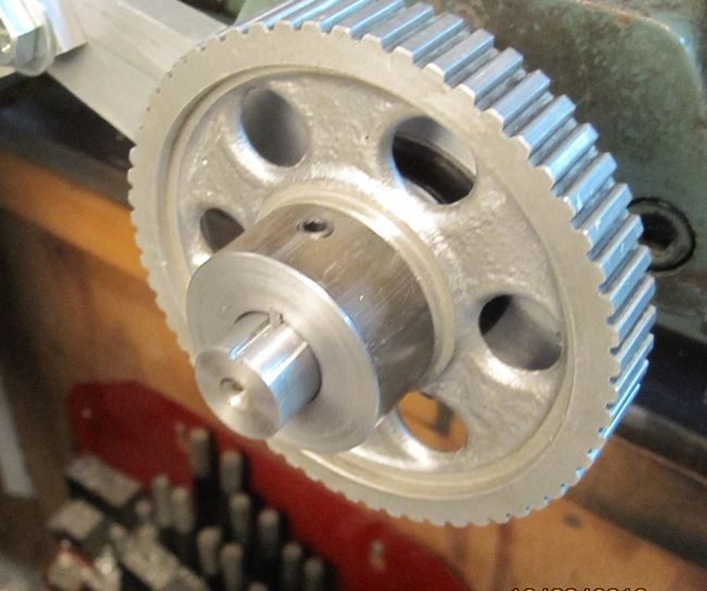

    Still waiting for the belts and the DB25 cable, so today I finished up the keyways.
    I cut a standard keyway instead of woodruff. That gave me a lot longer key. I used a 3/32" carbide end mill to cut the keyway in the shaft. Easier than I thought it would be. I made the key out of some .093" sheet steel I had on hand.
    Hope the cable and belts get her tomorrow. I'm anxious to get this thing working!
    Chuck
