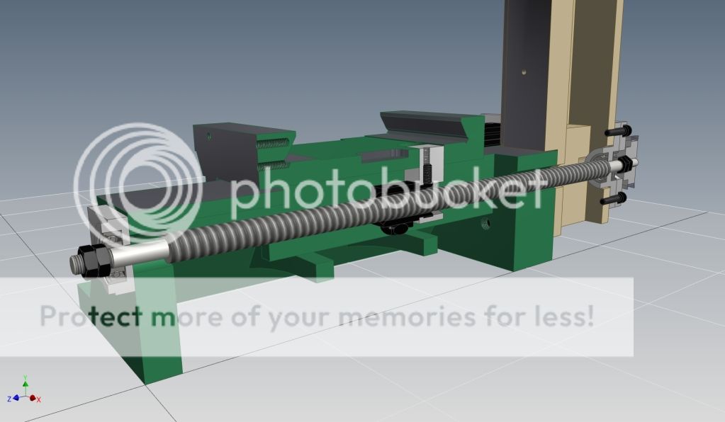

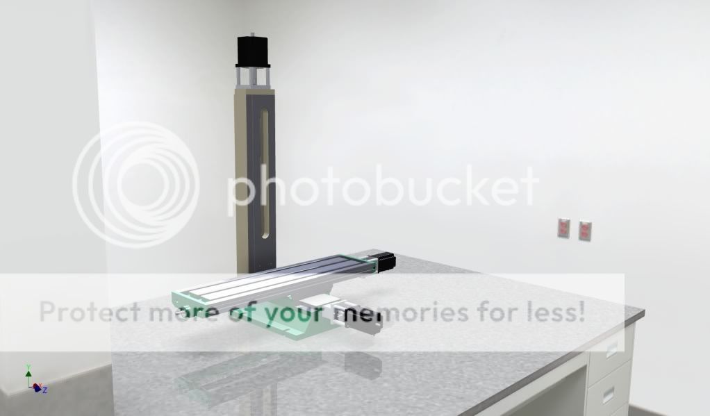

    I deleted my bogus wiring diagram (end of page 1) as to not lead others down the wrong path I was taking...

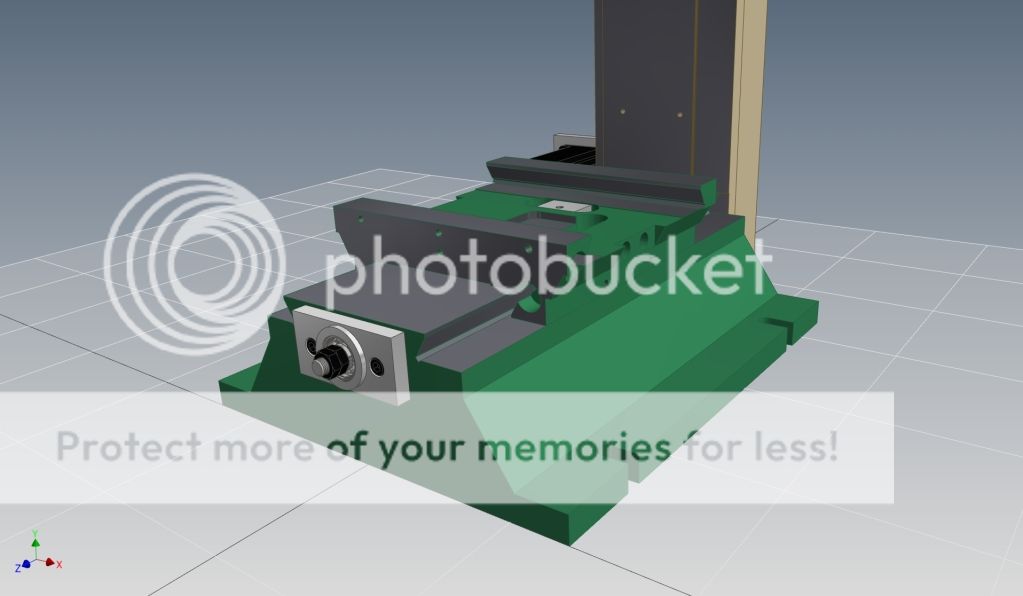

    Most all of the electronics and other hard parts are now in hand. So I started getting more serious about chipping away at the 3D model in Inventor however I still have a long ways to go. Right now I have all of the conversion parts drawn off the Hoss plans but am planning to change it up just to make it my own.
  7. #47
    Join Date
    Feb 2004
    Posts
    1311
    You need to add clutter to your table top, boxes in the corners and under the desk and swarf every where to make it look more realistic!
    Seriously, nice job!

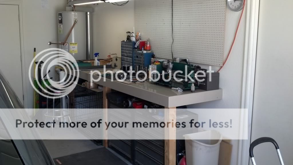

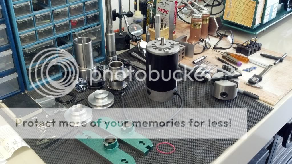

    Anyway here is an overview shot of my WIP "machining center" The bench is 2x4 construction on 16" CL with a 3/4" particleboard top that's covered by 12ga steel that wraps 3 sides, legs are 4x4's. I'm pretty tall so the bench is too.
    7x Lathe with it's most used tooling
    The only parts going back in the G0704
    Current state of the G0704

    Been chipping away at the control. Hope to have it all wrapped up by the time the weather cools down enough to revisit the garage and start working more on the mechanical. I did a temporary test run and got all axis working, the spindle is under mach control using the stock ESC and a game pad working as a pendant. My plan here is to get all control components mounted and wired to this board then mount it in a steel enclosure where I can then layout all of the I/O connections. Anyways, small update with a little progress.
  12. #52
    Join Date
    Jun 2008
    Posts
    36

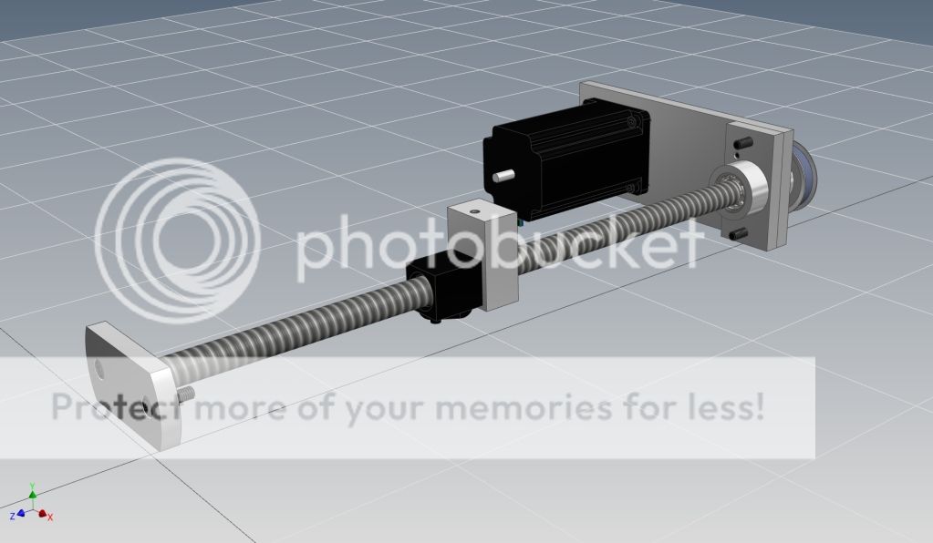

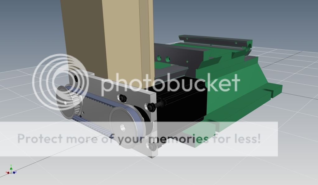

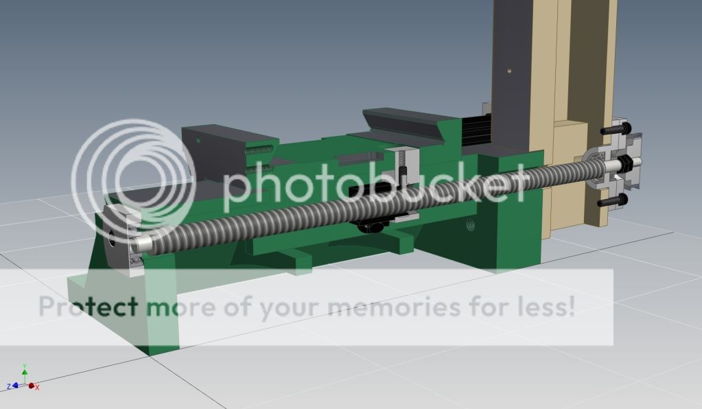

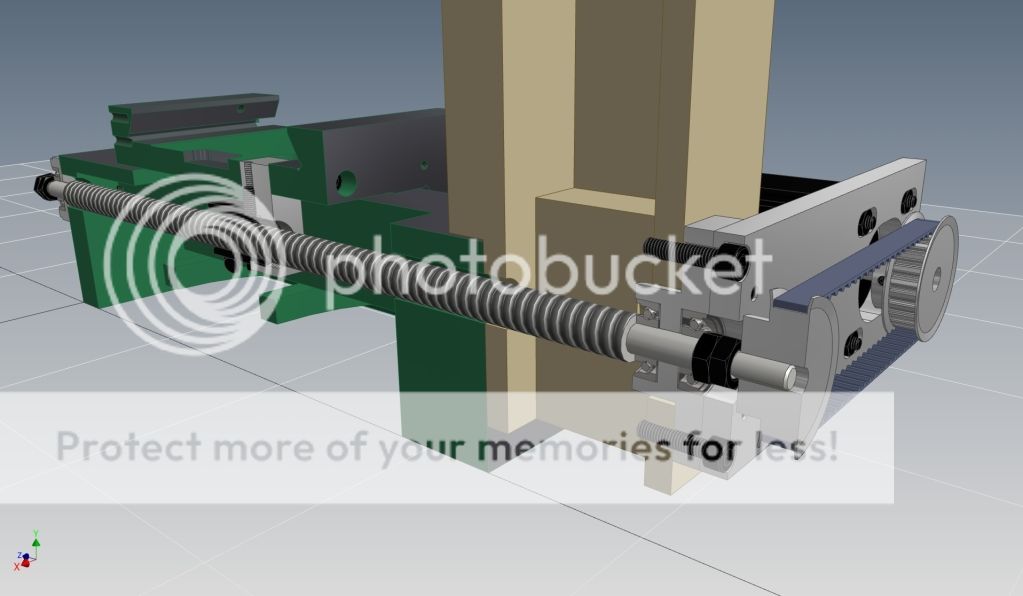

    Getting happier with the Y axis drive setup in the computer.
    I like the idea of a front bearing.
    26T XL pulley's
    Thinking of boring a 1.5" hole in to back of the column to sink the bearings into to minimize the foot print.
    Probably stupid but I was thinking the slot could capture the stepper mount nut.
    I know that I'm not breaking any new ground here but would love some feedback on this setup.
  13. #53
    Join Date
    Jul 2012
    Posts
    80
    I would think that you wouldn't want nuts on the front of the Y-Axis ballscrew, since this end it just supposed to float. The AC bearings at the back take the load, and the front bearing just supports the screw radially. You need to allow for screw length changes with temperature, so you don't want the same support on both ends.
    Other than that, it is looking really good.

    Quote Originally Posted by rob_b View Post
    .......Thinking of boring a 1.5" hole in to back of the column to sink the bearings into to minimize the foot print........I know that I'm not breaking any new ground here but would love some feedback on this setup.
    There's no issue with the 1.5" hole as I myself drilled the exact same diameter but in mm's of 40mm http://www.cnczone.com/forums/1068714-post70.html, but you may have to redesign your A/C bearing allocation.....have a look at the pic to see the reinforcing around the Column Bolt holes in the Column casting....now I know mine is the BF20 version but I asume that the Grizzly is similar but you should clearly be able to view the casting as you have your cloumn and base disassembled

    Quote Originally Posted by manton View Post
    I had originally planned to configure the Y that way but forgot when the time came to model it.:tired: Thanks for the reminder. Isn't it standard to nut each end of the X screw though?
    Quote Originally Posted by Mad Welder View Post
    There's no issue with the 1.5" hole as I myself drilled the exact same diameter but in mm's of 40mm... have a look at the pic to see the reinforcing around the Column Bolt holes in the Column casting...
    According to my measurements I'll only hit the reinforcement on one side and even then just barely. I have the OD of the bearing boss @ 1.400" to allow for a little alignment adjustment.

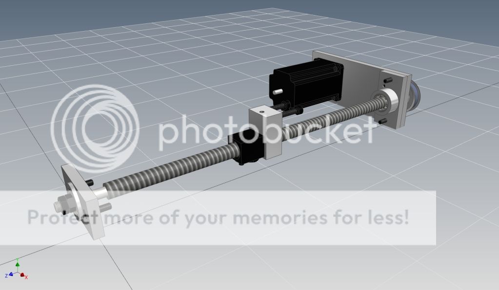

    Updated model...
    If nothing else it looks better. Eoin, I really like how you made your front bearing spacer out of round stock then milled the top flat so I'm stealing the idea...
    Here you can see better (in red) where the 1.500" hole will hit the wall.
    Oh, forgot to mention the spring pins to keep the stepper plate and bearing mount aligned.
    I think the only reason that the X usually has nuts on both ends, is to hold the handles on, at least on a manual machine. The end without preload, usually has the nut just tight enough to hold the handle on, it still allows the screw to expand an contract. Of course on a CNC machine, this would be different, especially considering that on a manual machine, the screw likely doesn't change temperature much, as the feeds are different, and the machine is not pushed as hard, for as long.
