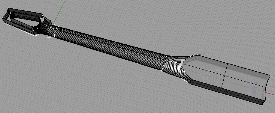

    limiting toolpath area?
    I'm a rank beginner at Rhino and Madcam so I'm glad to find this discussion.
    I'm attaching an image of a bass stick I'm making, most of which I already have toolpathed for 2D and would like to limit Madcam to the 3D surface of the neck areas. How do I go about that without it trying to cut to the table height at the ends?
    This is probably in one of the PDF tutorials but I haven't come across it yet.
    Any tips appreciated.
    Thanks
    David

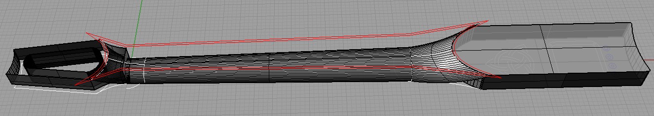

  16. #16
    I've watched those videos. Clipping planes don't seem to do the trick as I want to mill the neck region down to zero of the surface. The body and peghead I want to "mask" are 1.25" high. I've tried making a "region curve" but when I try to use it, it won't allow me to select it. It's a closed polyline. Isn't that right? Here's a sketch of it.
    I've tried positioning that region curve at the base and at the top of the work piece and enlarged it to allow for cutter diameter, but still it won't allow me to select it.
    Are you sure it's closed? Try using the CloseCrv command and see if it does anything. Or try CrvStart (or CrvEnd) and zoom into the point to see if it's really closed.

    Thanks Dan...
    You were right Dan, my region curve wasn't closed. Fixing that made it work quite nicely. I had to keep it pretty spot on the size and shape of the neck milling area to prevent it from cutting off the ends, but it looks good now. I'll let you know how it cuts.
    Thank you, and Sven for your help.
