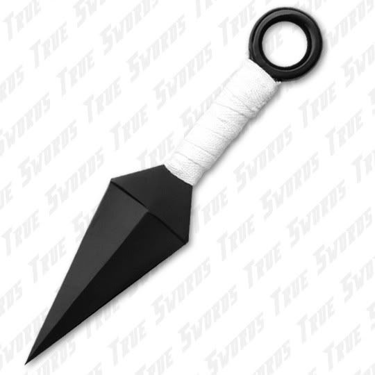

    What would I really be getting into? What would I need?
    Hi,
    This is my first real thread here, so please forgive me if I'm a naive.
    I'm an anime (Japanese cartoons) fan, and I started going to conventions in costume the summer I got out of high school. The characters I go in costume as often times carry very fanciful objects. As a result, I had to make many of these objects, and I found that it's a great deal of fun for me. As I'd show my works to others at these events, many were astounded by my work, and it made me wonder if this would be something that I could somehow make a career out of.
    Fast forward about 4 years, and I've made many more, and significantly more intricate props. I'm currently in college for psychology, but I still love doing this kind of stuff. After tying to get commissions and get some semblance of a start, I realized that what I'd need to make this sort of thing successful is a number of small objects that I could sell at a low cost and have people purchasing on a frequent basis.
    The problem is that in order to make many of these sorts of things, I'd need to be able to put them out in larger numbers than 5 at a time, and I'd need to be able to do it in a way that allows me to duplicate my works in a cost effective fashion. As of right now, I really only have typical power tools (disc sander, band saw, drill press, table saw, etc.), and all the details get done by hand tools (carving chisels, dremel tool, etc). I recently saw a carvewright machine in a woodcraft catalog, and since I primarily work with wood, plastics, foam, & aluminum, it seemed like a tool that I could get for a reasonable price that would allow me to start doing this sort of stuff in a more cost effective way.
    For those of you who know what one is, the carve wright can only handle materials that are 14.5" wide and 5" tall, but it can supposedly work with materials of any length. I started reading some reviews, and I found out that it's a good idea that's just too riddled with quality control issues to justify even a used price tag. That brings me to the idea I'd entertained for years of a CNC mill. But they're just so expensive that I'd probably have to take out a loan to purchase one.
    Then, I don't have any experience at all with CAD or CAM software, and all sources indicated that the carvewright software was extraordinarily simple to use, making it appeal to me for that reason as well. I don't mind taking classes, working hard to learn the programs, or even the $500 price tag for some of the suites, but the price of the CNC mill itself concerns me.
    I figure I'd need a 4'x6' machine at the largest. I'd like to have the ability to cut fairly deep on the Z axis too. It would NEED to be able to cut wood, foam, plastics, and aluminum. If I could get one that can cut ferrous metals as well, that'd be great, but it's not a necessity for what I do.
    I contacted torchmate, and they gave me a price quote of $15,500 shipped for a machine from them, but I've seen shopbots and other machines similar in capabilities for about $8,000-$10,000.
    I guess what I'm asking is this:
    If I really want to get serious about making stuff like what's in the pictures below, what do I NEED in terms of training, software, and a machine?

    I don't think a router or mill is going to allow you to make those parts fast enough to make money at it. But it depends on the level of detail you're looking for.

    As far as level of detail goes, If I can achieve the kind of detail that's on the assault rifle in the 2nd and 3rd picture, that'll be perfect for what I'm looking to do. Why do you say that I may not be able to make them fast enough though?

    I agree with Ger21. The level of detail seen in the 2nd or 3rd picture is indeed achievable with advanced CAM software and a nice CNC Mill, but it is nowhere near practical. The programming, setup, fixturing and machining times would be astronomical. And if you want to sell these things, theyve gotta be decent quality.
    Starting from nothing, it would probably cost $50,000-$100,000 in machines, tooling, software and time to make the gun shown in #3 by milling it from a solid block of aluminum, in a professional manner. (Disclaimer: rough estimate).
    My initial feeling here would be to mold these. Injection molding would be expensive, but vacuform molding might get a close product. (Think Mythbusters making a fake head) I would make the molds by hand, and you could probably produce a few hundred pieces.
    $.02
    I'd most likely be making something like that out of wood or high density foam. I use aluminum once in a while, but I'm primarily working with wood and materials of that density. I just wanted to see if it was possible to make a machine that could do everything I'd ever need.

    The original images you posted had far more detail than this one.
    I figured there would be some sanding involved, but I didn't think it would be that much. I guess if I create molds from an original though, it doesn't matter that much in the long run if it takes me a while to make a prototype to form a mold from. I felt like the level of detail that the assault rifle I linked to and the original pictures I posted were comparable in the level of detail they had.
