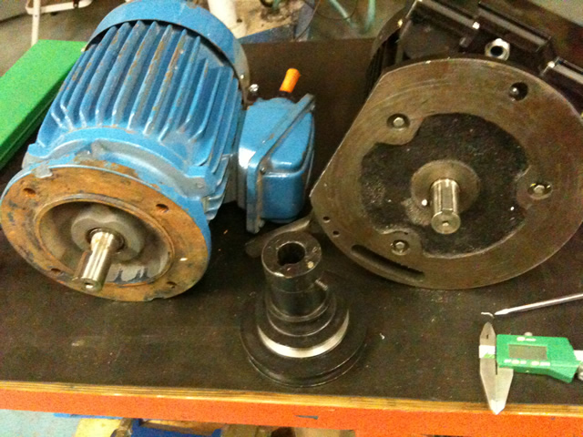

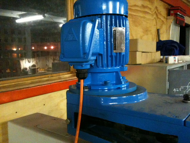

    I got a bit of time to do the VFD spindle conversion, after deciding to use the MESA 7I47S I/O card for spindle control, I have ordered one, but delivery will be in October, so in the meantime I want the ability to manually override the automatic control anyway.
    A PDF of the preliminary circuit design is here ... http://www.backsaw.net/pics/HM52_Spindle_Circuit.pdf
    The circuit diagram contains notes on modifications required to the HM52 wiring.

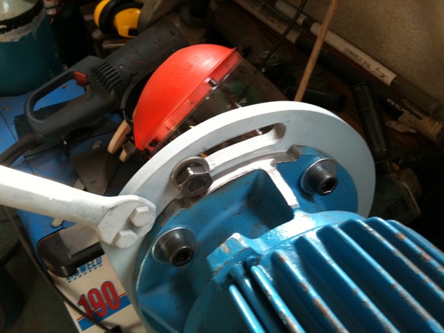

    The motor I got was a 1.5kw TECO (from ebay) and the VFD happened to be a TECO FM50 (again off ebay)
    The shaft diameter and keyway was the same as the original motor, which made things a bit easier.
    The flange mounting bolts are the same on both motors, it's a standard 90L frame but the spacing and bearings are different, so I have to make an adaptor plate.

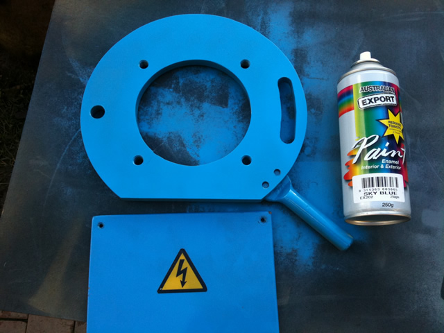

    This was cut from 1/2" aluminium plate on the bandsaw and finished by hand (no mill you see!)
    The flange on the teco interferred with the mounting bolts so I had to grind a bit off the flange to clear the washer.
    The finished adaptor plate, the colour is "sky blue" to match the H&Fcolour scheme..
    I cleaned the motor and primed it with Galmet and then painted it to match.

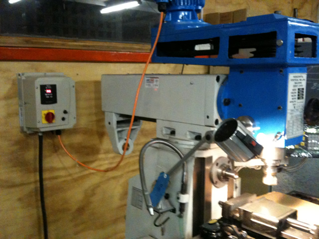

    VFD temporarily mounted on the wall, The new control panel will go on the front of the machine, where the H&F nameplate used to be. This frees up the side of the Quill for the Z axis.
    The front panel will have a RPM display which will pick up the spindle speed directly from the spindle itself, so that when adjusting speeds
    the belt configuration is automatically corrected for.

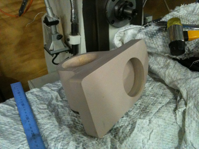

    Z axis progress update,
    After playing around with dozens of variations of different ways to do the bearings, I finally settled on NSK 7912A5 AC bearings and housed in a cast mount.
    Here is the general arrangement
    The quill return spring stays, but with a different spring, tensioned to just balance near the top of the travel. The back of the ballscrew bearing mount is cut out to accomodate the quill return spring.
    I still have to make the core molds, and the parting line will be centered on the axis of the main bearing. The quill spring cutout will be filled in before casting, and machined out after.
    The center of the quill clamp need to be built up before casting, to accomodate any shrinkage, and then machined to finished size afterwards.
    Material will be aluminium bronze.

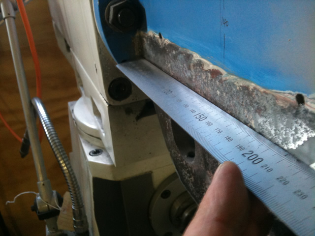

    The side of the mill where the bearing mount is going to go is dished and the next job is to try and flatten it as much as possible..
    I've got most of the bog off and now trying to come up with some way of flattening it..

    Can I suggest removing the head and mounting it to your table. Then you can mill it flat with your horizontal spindle. You will either have to electricaly disconnect your vertical spindle motor OR just remove your vertical spindle motor and hang it from a rope out of the way while it is removed.

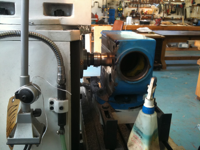

  6. #26
    Thanks, Chich, the motor cable was long enough to leave it connected.

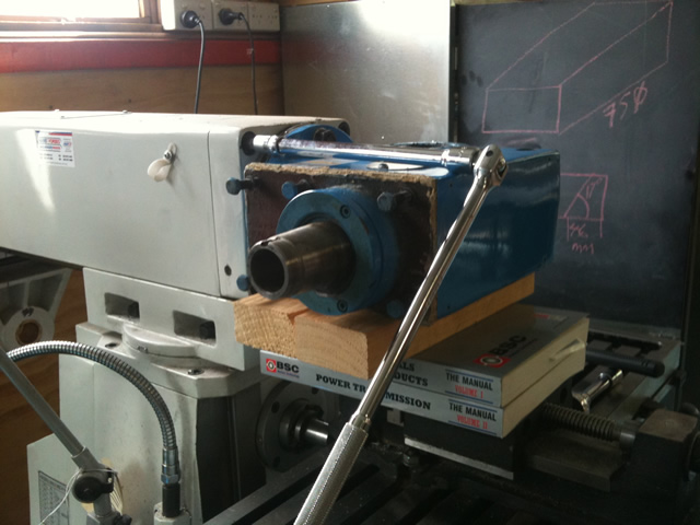

    No sense in waiting around, I stripped the head assembly as much as I could, using the knee to support the spindle and gently lower it out, worked a treat.
    No need to disconnect the motor wiring, just unbolt the motor and leave connected.
    Thanks Dave (on the other forum) for the advice on removing the head, those big 12mm hex bolts have to come off first. The head is trapped by the gear/worm drive that does the head rotation.

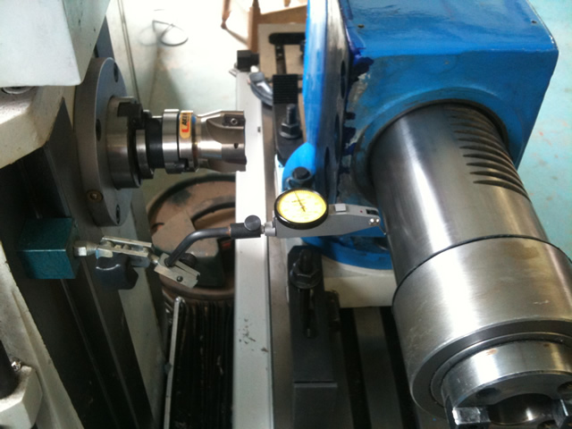

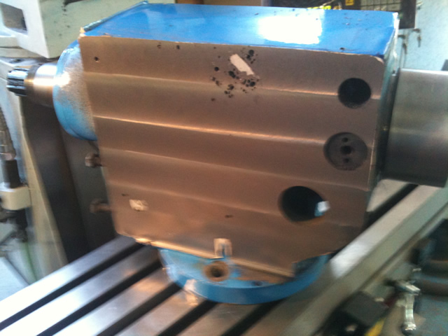

    I used the Knee, wound all the way up, and a bit of packing to support the head, and then when it came loose, used the Y axis to back it out of the column. No heavy lifting required. (No swarf in the worm drive either)
    I put the spindle back to use as a reference to tram the assembly alignment to the X axis table. With a DT indicator.
    Lots of light passes, in hindsight, I probably could have done it two cuts, but it's a bit nerve racking watching your mill slowly eating itself..
    At last a flat surface, parallel to the spindle.
    The machining uncovered a few porous patches in the casting, not sure justyet, but a bit of bog seems to be the original manufacturers cure for all these issues...
    Now where do all these bits go?

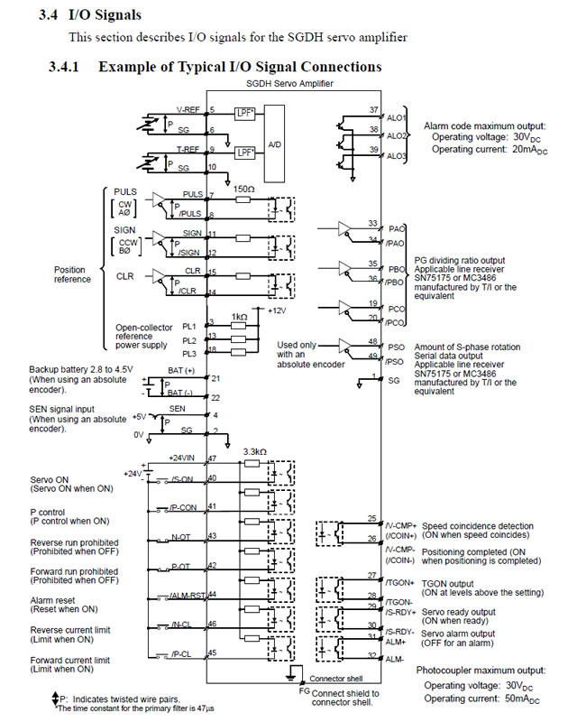

    The drive configuration for +-10v analog control
    Pn000 Digit0 =0 Digit1=0 (analog reference) You would use 1 here for pulse train reference
    You wouldn't use these parameters, I don't think.
    Pn100 = 20 (gain)
    Pn101 = 5000 ( 5 seconds)
    Pn300 = 1000 (10v=100%)
    The connection to the parallel port, is step signal supplies current to opto isolator in the drive, via pins 7&8 and direction signal to 11&12.
    The overtravel inputs inhibit drive output in the direction of travel, so you can still reverse off the limit switches. You need an external 24v dc supply to drive these..
    +24v dc goes to pin 47, and 24v ground is switched to the inputs.
    Refer to the circuit diagram in the manual for confirmation that your model is the same as mine.
    Pin 40 is servo on
    Pin 42 is forward inhibit
    Pin 43 in reverse inhibit
    I'm leaving out other connections, but you need to supply power to these inputs to get the servo running. Especially the inhibit inputs, when these are OFF the servo is inhibited (fail safe)
    Regards

    Hi Ray,
    The analog input is a voltage input that varies from -10v to +10v, to use the step direction inputs you don't use the analog signals.
    You want to configure it for digital inputs NOT analog. The digital outputs are from the parallel port (on your PC running Mach3) and need to be buffered to drive the digital inputs on the servopack.
    If you look at this circuit diagram, you will see that all the signals you need to drive the servopack are driving opto-isolators inside the drive, so you need to supply external power to drive the signals.
    The step signal connects to PULSE input, and the direction input connects to the SIGN input, you don't need the CLR signal. make sure you get the polarity correct.
    The other signals you need are the 24v dc signals that is the switch inputs as per the diagram above.., S_ON, and don't forget the limit switches should be connected to the N_OT and P_OT, if you are just bench testing, then you can just wire these inhibit inputs to be on all the time. But the idea is that the travel limit for forward will inhibit forward motion, but not inhibit reverse, so you can back off the limit switches under program control. If you don't provide these signals the drive won't run.
    Finally...
    The configuration should be set to pulse train reference.
    This is Pn000 digit 1 == 1
    Do you have the manual?
    Regards
    Ray
