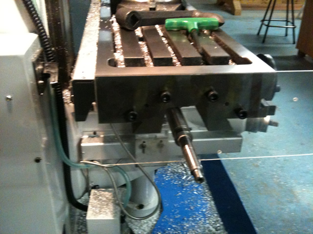

    HM52 finally arrives
    Time for a progress update on the project.
    The HM52 arrived last week, after a month waiting it's good to finally have the machine so we can finalize some of the design questions.
    We are starting by installing the ballscrew on the X axis, and then using that experience convert the Y-axis to ballscrews.
    Here is the bottom of the cross slide for the table.
    A new ballnut mounting something like this will replace the existing leadscrew nut
    After some discussions with RodM and DaveJ on the other forum, it was decided that we needed a means of adjusting the rotation of the ballnut, so the bolts will come in from the bottom of the crossslide, (so they can be accessed when the table is assembled with the cross slide in place) and the holes will be a little oversize to allow for the ballnut to be aligned by running end to end before finally tightening.
    The x-axis power feed is on the right hand side (that's the free end of the ballscrew), and the thrust bearings are on the left, so we will retain the existing bearing support on the right hand end, and reference everything from the axis of the existing leadscrew. That means we have to machine the ballnut mounting surface slightly lower to keep the centerline of the ballnut in line with that reference point. After a lot of mucking around we referenced from the ground surface of the dovetail slide and will machine that with the table removed, and the crossslide rotated 90 degrees and using the Y-axis feed and turret to machine the ballnut mounting point.
    The new servo mounting plate and AC bearing block will go on the left hand end, and the plan is to re-assemble the machine and using a center finder with the DRO as a digitizer to digitize the hole locations to match the existing centers.

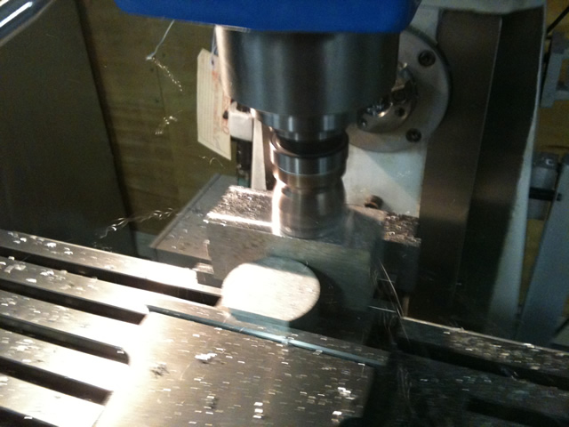

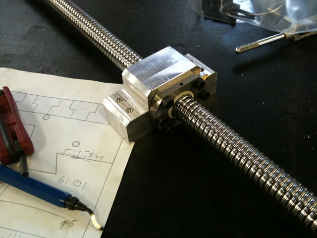

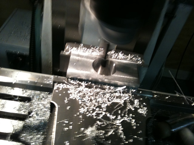

    X-axis ballnut mounting
    The ballnut mounting for the X-axis is now finished.
    Squaring up and facing the stock, the finish from the indexable face mill is nice.
    Boring the 40mm hole for the ballnut.
    The finished part, with a bit of chamfering to clear the bottom of the table dovetail.
    The ballnut mounting holes locations were transfer punched using the ballnut as the template
    and then tapped for M6, the holes for mounting to the cross slide are tapped M8 and the holes
    in the crossslide will be drilled oversize to allow for alignment.
    Only design issue I can see at this stage is the grease nipple needs a little more clearance.
    Next task is to finalize the design and making of the servo mounting plate.

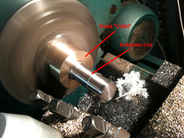

    Machining Ballscrew ends
    Time for a late night update

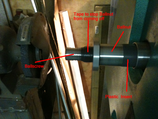

    It's getting close to the time for machining the ballscrew ends, so I figure I should make sure it's going to work.
    The critical things are, not to damage the ballscrews, so the ballscrew is held in a brass "collet" of sorts,
    the ballscrew passes through the spindle and there is a plastic insert to center the ballscrew and provide a bit of support.
    There is a few layers of tape to stop the ballnut from unwinding off the ballscrew.
    I don't want to have to learn how to reload ballnuts just yet..
    Here is the back of the lathe spindle.

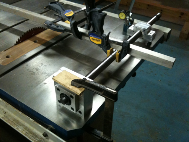

    The brass collet setup.
    The brass "collet" is machined to be a sliding fit over the ballscrew, and I have cut slits in the section
    where it is clamped by the chuck. The runout is checked with a dial test gauge. I didn't feel the need
    for a center on the tailstock, but machining longer sections I might need it.
    The ballscrew is hardened, but as RodM had pointed out earlier, one you get through the hardened threads
    it went fairly smoothly with TC insert cutters. Light cuts and low feed rate until you get past the ball threads.
    Interrupted cuts on hardened material (not to mention expensive parts) make for nervous machining...

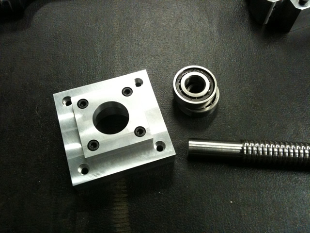

    Here is the finished test part. With the AC bearings and bearing housing.
    The idea here was just to do a test to see how easy it would be to setup and how hard it would be to machine,
    expensive little things these ballscrews, can't afford to have any stuffups.

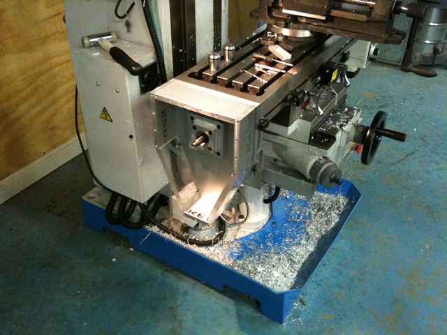

    x-axis conversion continued
    Time for an update on the progress of the x-axis conversion to ballscrews.

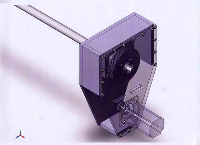

    Here is the final x-axis servo mounting design.
    Some pictures of the build so far.

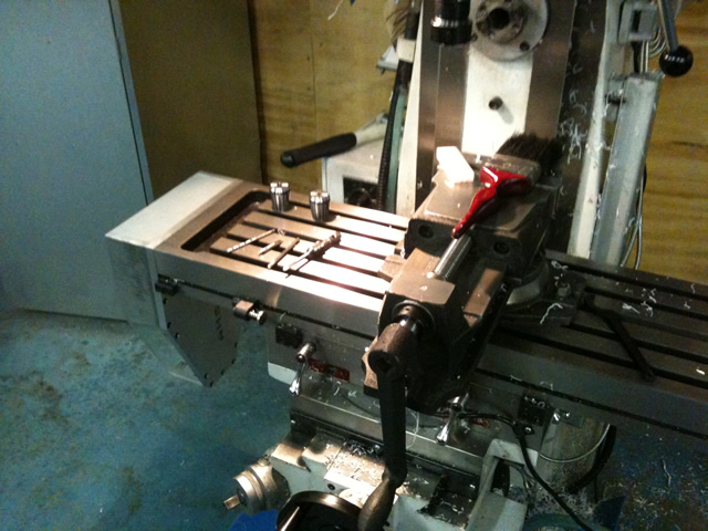

    Using the dro to digitize the hole pattern on the end of table.
    Made a test part using acrylic to double check the hole locations. Once
    finally locked down there will be a couple of new dowells fitted.
    Test fitting the servo mount, the bottom panels are perspex.
    The next job is to machine the ballscrew ends, now that we can get the final dimensions. After that it's time to pull the table off and machine the ballnut mounting , at that stage we will be running the x-axis with ballscrews, no servo control yet..... but almost...
    Credit for the machining goes to my son Josh who has done an outstanding job.. One day, I might get to have a go too...

    Some test fitting and preload setup for the vxb ac bearings.
    Here is a sketch of the bearings,
    After reading all the posts I could find on cnczone.. (lots of them) on how to set up the preload, I was
    more confused than ever, so I set up a test system to try a few different things.
    The bearing block is clamped to the table saw table, and a dial test guage is
    set up to watch the movement of the ballnut. (later I clamped the ballnut to the table to simulate a load)
    I clamped a 6' aluminium tube to the ballscrew, so I could get really small amounts of rotational movement of the ballscrew. Just rocking the end of the aluminium tube slightly produced deflection back and forward on the dial guage. (minimum divisions 0.01mm)
    The bearings are stacked numbers out, large inner races facing inwards, and when clamped up the outer races were touching and the inner races slightly loose. So I made shims for the inner races.

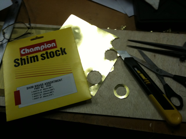

    I couldn't detect any backlash with 1 thou shims, and I could feel a very slight increase in drag when compared with no shims, when I increased the shim to 2 thou, there was a noticable increase in drag, but still no measurable backlash.
    The setup for making the shims is pretty basic, just a stanley knife and a pair of scissors.
    I will probably go with 1 thou shims, but now I have a much better handle on how to go about the setup.
    I can wait to see what it's like when installed on the mill, then fine tune a bit if needed.
