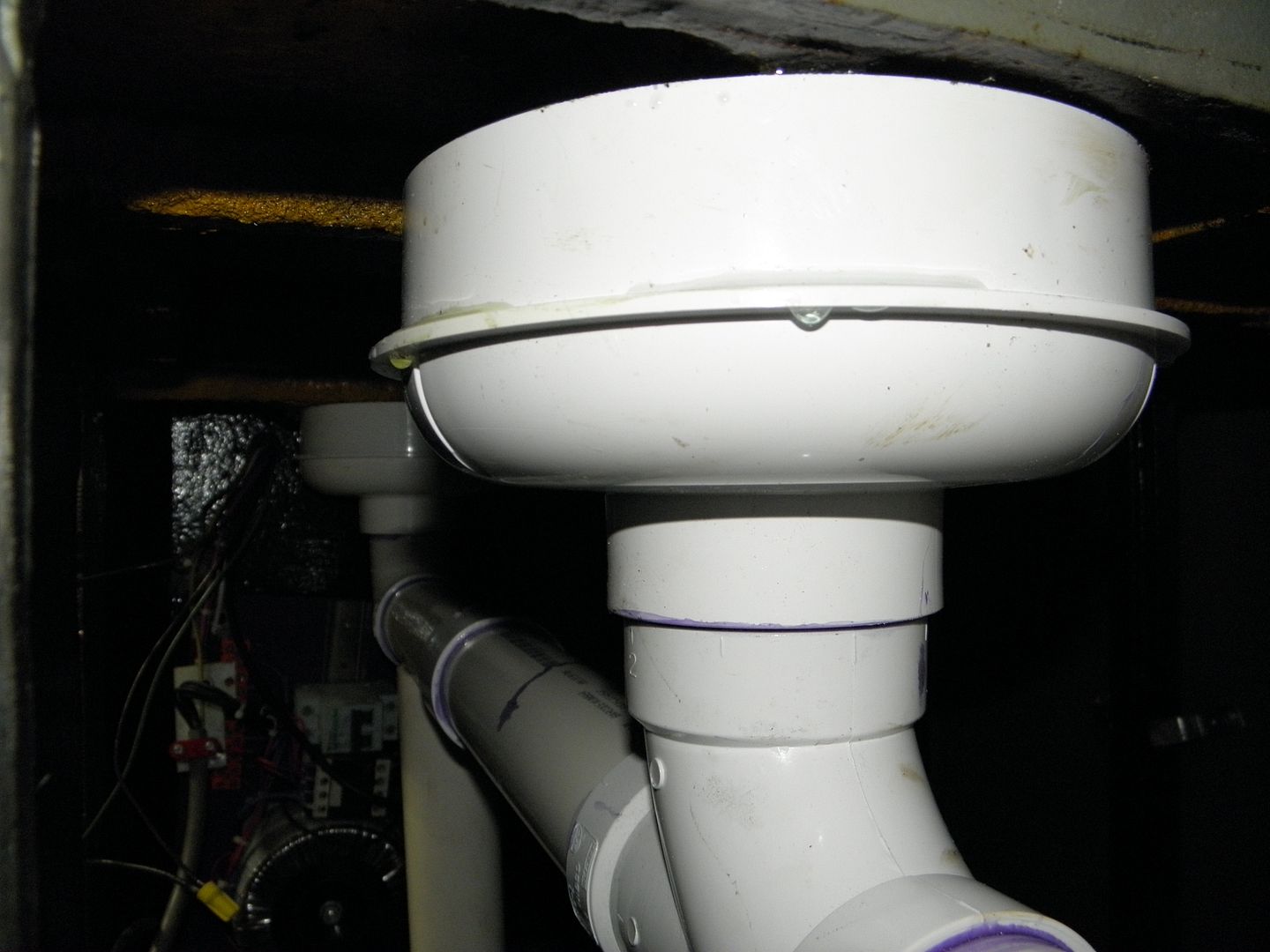

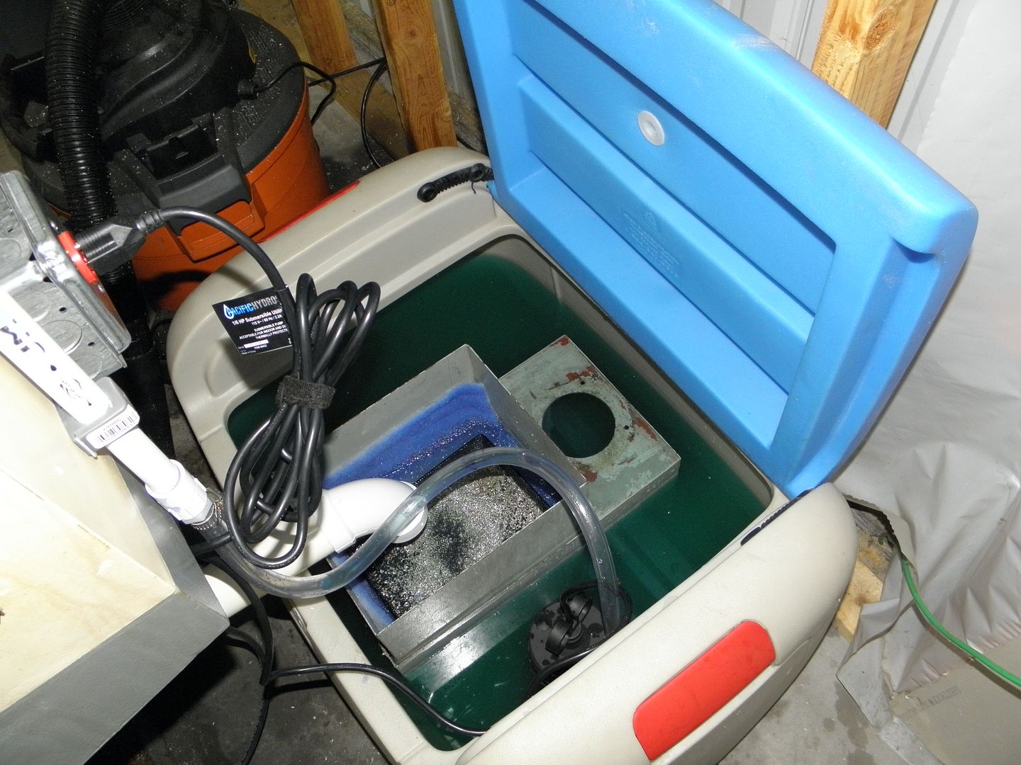

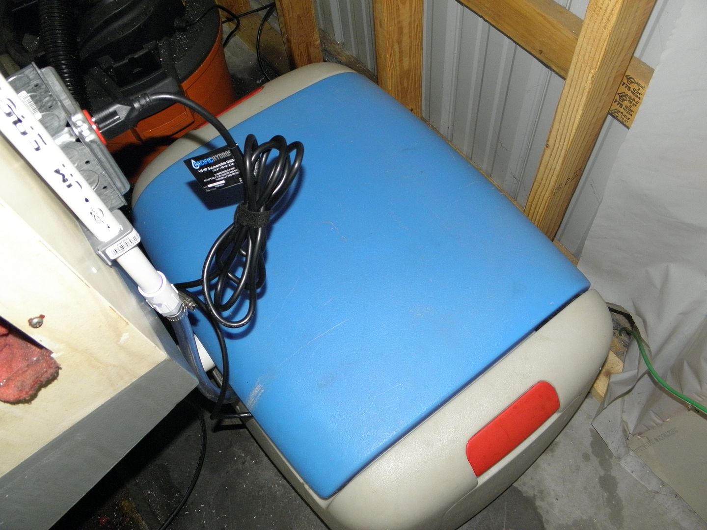

    Hello Christopher, Although not a Tormach, I basically converted my mill's coolant system, in the same way as you have. I also had issues with the the amount of coolant overwhelming the original drain system. Here's a couple things I did .........
    I eliminated any type of screening/chip catching in the pan area and moved that function externally. Basically, let the chips flow out with the coolant.
    Here's a pic of my tank... (don't laugh, my grandkids out grew the toy box and I just repurposed it)
    I also repurposed the original coolant tank. It acts as my chip collector/strainer. Here is a shot of the original tank inside the toy box (with 20 gallons of coolant). I'm probably going to drill some holes in the original tank to facilitate the overflow. I just didn't do it yet, till I have seen how the system works.
    I found that cleaning out the chips is so much easier this way.
    In my situation, I also installed a second drain opposite to the old one. now I have drains on the left and right sides of the mill.
    Lastly, since you installed a nice pump, you may want to install one of these to help clean the machine....
    So much better than using air
    pete

    Quote Originally Posted by slowtwitch View Post
    That looks like a fantastic idea for a coolant return upgrade which I may have to incorporate. Here's what the coolant system looks like now.
    Tormach PCNC 1100 - Further Flood Coolant System Upgrades, Maximizing Flow - YouTube
    Skip to 4:30 to see the flow going into the enclosure.
